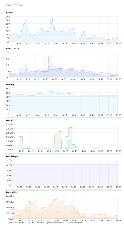

Hello,
I migrate my site to a new server with 8 GB Memory / 4 AMD vCPUs / 160 GB Disk, but the site is not stable, because There is no errors if run wo log show lovcour.com --php --mysql --nginx, but, sometimes the mysql will get down, sometimes get errors or warnings.
Really expect experienced instruction on how to tune the database, or share an optimized 50-server.cnf
Thanks in advance, and the following information for reference:

read_buffer_size = 2M
read_rnd_buffer_size = 1M
# * Query Cache Configuration
# Cache only tiny result sets, so we can fit more in the query cache.
query_cache_limit = 4M
query_cache_size = 64M
# for more write intensive setups, set to DEMAND or OFF
query_cache_type = 1
# * Logging and Replication
# Both location gets rotated by the cronjob.
# Be aware that this log type is a performance killer.
# As of 5.1 you can enable the log at runtime!
#general_log_file = /var/log/mysql/mysql.log
#general_log = 1
# Error logging goes to syslog due to /etc/mysql/conf.d/mysqld_safe_syslog.cnf.
# we do want to know about network errors and such
log_warnings = 2
# Enable the slow query log to see queries with especially long duration
slow_query_log = 1
slow_query_log_file = /var/log/mysql/mariadb-slow.log
long_query_time = 10
#log_slow_rate_limit = 1000
log_slow_verbosity = query_plan
#log-queries-not-using-indexes
#log_slow_admin_statements
# The following can be used as easy to replay backup logs or for replication.
# note: if you are setting up a replication slave, see README.Debian about
# other settings you may need to change.
#server-id = 1
#report_host = master1
#auto_increment_increment = 2
#auto_increment_offset = 1
#log_bin = /var/log/mysql/mariadb-bin
#log_bin_index = /var/log/mysql/mariadb-bin.index
# not fab for performance, but safer
#sync_binlog = 1
#expire_logs_days = 10
#max_binlog_size = 100M
transaction_isolation = READ-COMMITTED
binlog_format = ROW
# slaves
#relay_log = /var/log/mysql/relay-bin
#relay_log_index = /var/log/mysql/relay-bin.index
#relay_log_info_file = /var/log/mysql/relay-bin.info
#log_slave_updates
#read_only
# If applications support it, this stricter sql_mode prevents some
# mistakes like inserting invalid dates etc.
#sql_mode = NO_ENGINE_SUBSTITUTION,TRADITIONAL
# * InnoDB
# InnoDB is enabled by default with a 10MB datafile in /var/lib/mysql/.
# Read the manual for more InnoDB related options. There are many!
default_storage_engine = InnoDB
# you can't just change log file size, requires special procedure
innodb_log_file_size = 128M
innodb_buffer_pool_size = 768M
innodb_log_buffer_size = 72M
innodb_file_per_table = 1
innodb_open_files = 500000
innodb_io_capacity = 500000
innodb_flush_method = O_DIRECT
# * Security Features
# Read the manual, too, if you want chroot!
# chroot = /var/lib/mysql/
# For generating SSL certificates I recommend the OpenSSL GUI "tinyca".
# ssl-ca=/etc/mysql/cacert.pem
# ssl-cert=/etc/mysql/server-cert.pem
# ssl-key=/etc/mysql/server-key.pem
# * Galera-related settings
[galera]
# Mandatory settings
#wsrep_on=ON
#wsrep_provider=
#wsrep_cluster_address=
#binlog_format=row
#default_storage_engine=InnoDB
#innodb_autoinc_lock_mode=2
# Allow server to accept connections on all interfaces.
#bind-address=0.0.0.0
# Optional setting
#wsrep_slave_threads=1
#innodb_flush_log_at_trx_commit=0
[mysqldump]
quick
quote-names
max_allowed_packet = 64M
[mysql]
#no-auto-rehash # faster start of mysql but no tab completion
[isamchk]
key_buffer = 16M
# * IMPORTANT: Additional settings that can override those from this file!
# The files must end with '.cnf', otherwise they'll be ignored.
# === Table Settings ===
table_definition_cache = 1000
